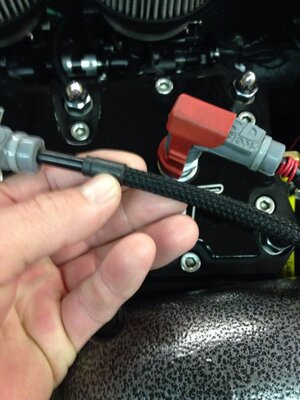

Stockton
One thing I should mention is the JSS coil is an OE with modified wires & coverings. Basically OE coil that are refurbished or new with a high tension wire & covering mod I do believe. I'll take a picture of mine and post in a bit
