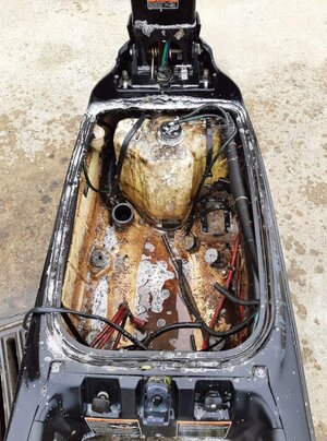

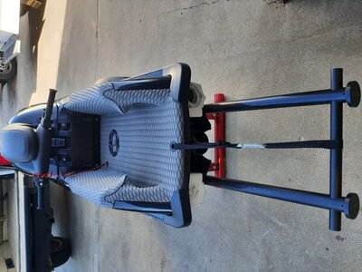

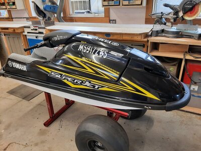

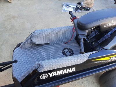

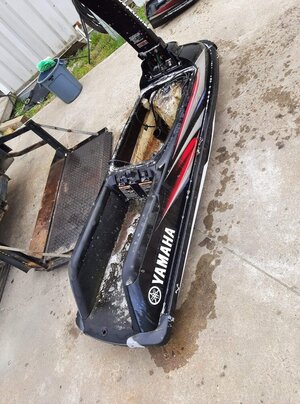

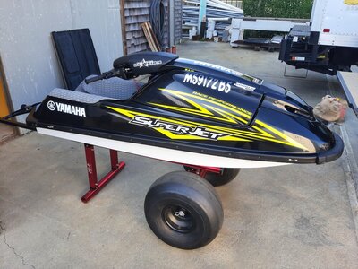

Last year I got gifted with an abandoned 2006 yamaha superjet thats been sitting in the bush since 2008 and the enthusiast that I am, I decided to return it to its old glory and ride it.
It took me one year to get to where it is right now and so far I am happy with how it turned out. New paint new graphics, new turf, installed footholds, It have a refurbished engine from SBT, new hooker impeler 10/16 , solas 12 vane pump, d cut ride plate, msd CDI set at 8000rpm, msd Ignition coil, wires etc., ....... and brand new dual aftermarket

Thank you in advance and here are some pictures of before and after
