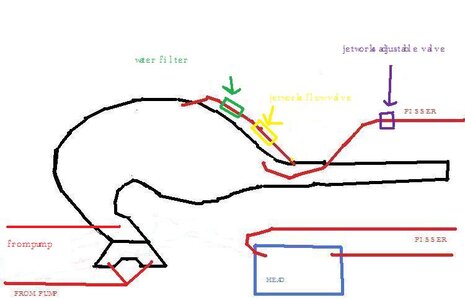

Whats the best way for routing and running a dry pipe. i'm going to run it dual cooling so i have that covered. i'm looking for the way you rout the lines and how dry to get it and how to dry it out. I'm running one line to the manifold and one to the first fitting on the chamber and then from there i'm not sure what to do it's my first dry pipe thanks.

My dry pipe setup I have the two cooling lines as you said, the fitting on the top middle of the expansion chamber goes to the smooth fitting at the stinger with a flow control valve in that line, the barbed fitting at the stinger I have going to an overboard pisser, then from the head I have two fittings both are an overboard pisser hope that helps

This is how I'm going to run mine this year and experiment with the different control valves, to get the pipe as dry as possible and the right temp to get the best performance out of the motor.

Yes, use one. Without the jet you'll get more water than necessary when the flow control opens.. and it helps make the water a spray instead of a stream.
