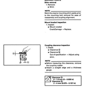

You have to get the engine setting in the mounts so that the coupler halves are level at the top and bottom. Check out the pic below of the Yamaha manual page about shimming the engine. You can use washers but it might be hard to get it right. Get some Stainless engine shims of various thickness and go to it before you destroy expensive parts.
Coupler is in spec, I'll take pic to verify but to my eyes and tools its level.... I've put 10+ tanks through it too, how many tanks would it take to notice coupler measurement issue?
I got the dshaft in, just loosened rear motor mounts and bam it went right in, it's only off by a couple mm if that I think.

Did you check the coupler alignment with the rubber dampner removed? It will look ok if the dampner is installed and will fool you into thinking it is ok. If you have to pry on something or remove the midshaft coupler bolts then something is out of whack and you need to correct that. The pump should slide in easily if the splines are lined up. If you run it in a bind something will eventually wear out prematurely.
