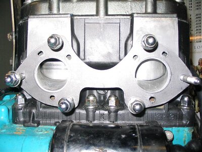

My sxi pro has brand new sxr bore wisco pistons so I figure it will run hotter. I just tapped the wet pipe manifold for a second cooling line and looking at pic. does anyone enlarge or add more water passages in the gasget? I will have 2 water exits from the head. Thanks.

I always doubled the cooling holes in the gasket when I built 750 race motors with dual cooling lines. Keep in mind that you NEED to increase the piston to wall clearances if you do!
