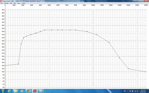

Programming the unit:
Two things you have to do before you start making your curve the first is set your rev limit to 16.000 rpm if you want an 8.000 rpm limit you need to do this because the unit is made for single cylinder engines.
Second set your `tach in` to raw hall and your pickup reference to 10 degrees that`s the width of the magnet in degrees.
Now you can make your curve just remember the curve has to be extended to 16.000 rpm, just like this one
No static timing required just set it to TDC.
