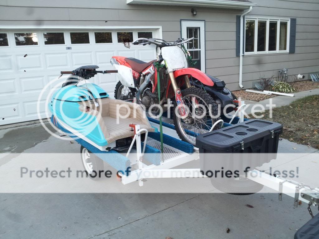

Thought you guys might like this. Its a pretty popular mod in NZ but hadn't seen it when I lived in the states (I think it's because its a pain to have multiple trailers with the 6mo inspections and annual registration fees).
Anyways, I threw this together out of some scrap angle iron and some bolts, so FREEBIE. I still need to build a second and paint or galvanize them both.

Very innovative idea though. Like it. The front tire stop comes up far enough to not hit the front of your ski???

It probably hits the nose of the ski, but I don't leave the ski on the trailer with the rails on, slide it off onto a stand in the garage, bolt the rails on then load up bikes. Only takes a few minutes to do.
