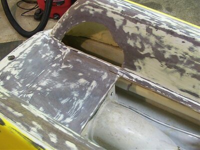

depends on how much work you wanna do and how much easier you wanna make it.
i did a little hole on my SN and the entire tray on my RN
