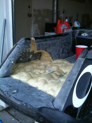

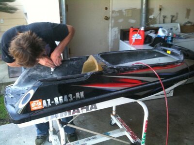

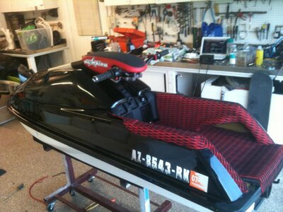

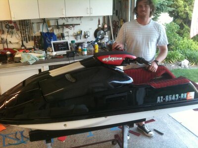

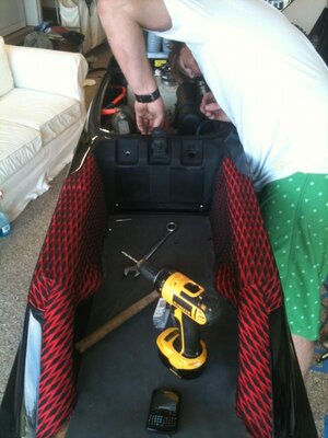

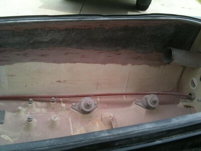

Our good friend Peter decided that he enjoyed riding water scooters in the surf. So he decided to buy an 06' SJ and make a nice $5k order through Blowsion. Peter is very new and unfamiliar with jet skis so Jon Hall (Jhall752) and myself built the boat for Peter. I was in charge of the composites, foam, reinforcement, footholds. Jonathan performed the entire assembly, turf, and tune-up at Jet Works (he works there, so be nice to him :439: )
Unfortunately, we don't have all of the pictures. Peter was there taking pictures, monitoring, and helping out when he could.

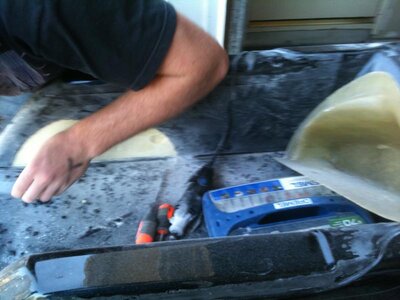

Here, we just took everything off and started cutting stuff up! We had to cut the tray because it was so incredibly warped.
KR
www.krlines.com

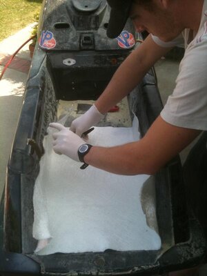

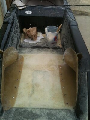

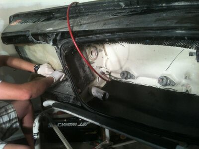

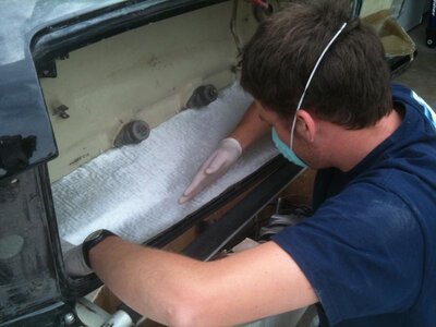

I used the 406 micro-balloons, maybe 407 - I forget. Anyways, used that as the filler under the hood line and bond rail.
As far as reinforcement went, I decided on a 12oz mat followed by 8oz carbon. And of course, West System epoxy :biggthumpup:

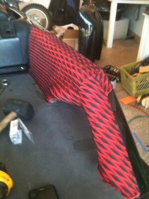

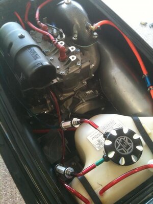

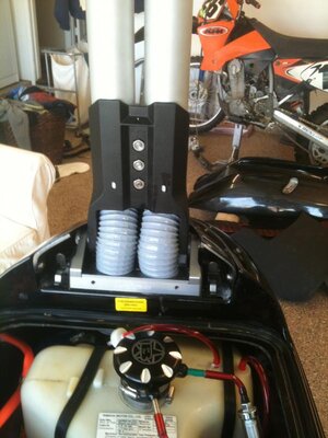

Jono hard at work! He did a great job! Look at those smiles!
A few key parts that made this boat: Blowsion destroyers, Full carbon hood, RRP, two tone turf, New B-pipe, and most any other anodized part from Blowsion you can think of.
