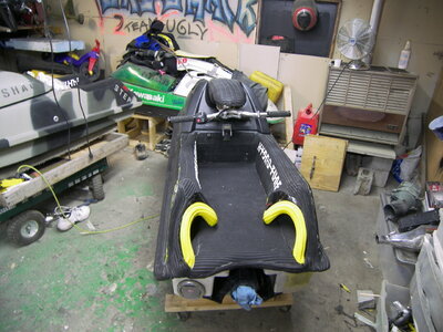

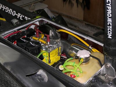

Well here it is. My 1995 SN SuperJet.
Ported 62t cases
Ported 61x 82.00mm
Ported Factory Pipe Exhaust manifold
Team Scream Mod Chamber
ADA Girdle Head
R@D intake
Delta V-Force 1 Reeds
Factory Pipe Alum waterbox
Twin 48mm PowerBomb
Pro-K's
Rad Flywheel
MSD enhancer
Umi Throttle Drum
XFT footholds
RN pole/conversion bracket
Blowsion chinpad
Umi Bars
Umi plate/bearing kit
Blowsion Throttle lever
Odi Grips
24/7 scupper
24/7 hood latch
Bilge pump/blowsion bracket/switch
JD scoop grate
D-cut stock rideplate
13/16 3mm cutback solas
Stumpy cone
Bored nozzle
Quick steer nozzle
Shortened hull
Hydro Turf with 25mm underpad
Stock hood modification
Front exhaust
Carbon Kevlar reinforcing
Its no showboat....more of a sleeper....yeah thats it...a sleeper ski. All it needs is a TBM supercone and a roundnose hull. :cool2:
