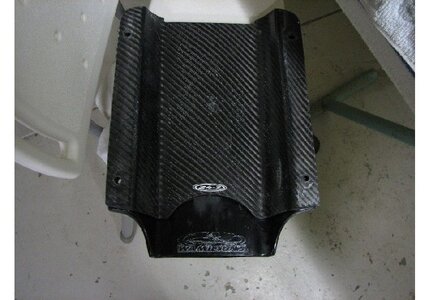

I'm chopping my Wammer plate up, how big of a semi-circle would you chop out?
Just to clarify, I'm meaning a semicircle cut out of the back, not a rideplate with a D cutout in the middle.

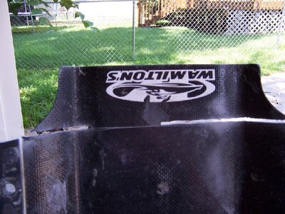

On my protec plate, I measured back 3 inches from the rear and centered up a paint can on the line and traced it. Then I used a jig saw w/ fine blade. It will sure make the front end ride high at low speeds and jump a lot easier, but WOT gets a little dangerous!

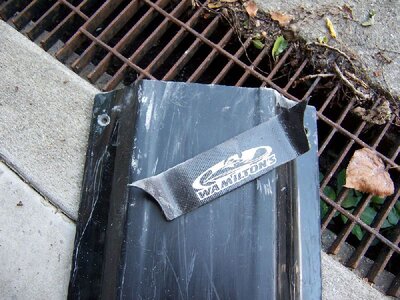

this may help

i too measured up about 3" and drew a circle from there. i did after lobing off the end as you have done, i noticed lenzis iscut prior to cutting off the 100mm you cut off, but i dont like the 2 dagars it leave on the plate.
