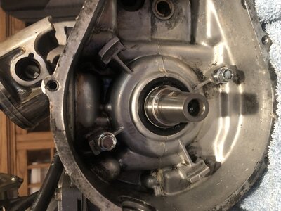

Does anyone know how to install a crank seal on a 95 super jet 701? I just ordered the parts because I know I am overdue for a new seals and I was wondering if I indeed have to split the case or what? If anybody has a video on this process that would be very helpful, thanks.

Yes you have to split the cases.
Your also going to need some ThreeBond 1211, 1184, Yamabond, hondabond or equal sealant for the cases.
