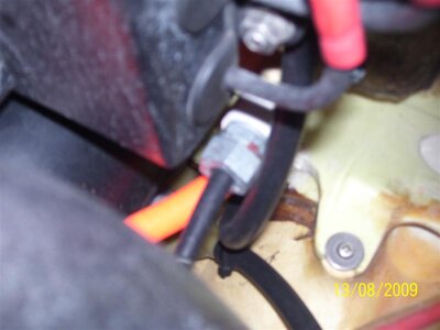

I have my trim all installed on my SJ. But how in the heck am I supposed to tighten up the cord gripper. I cannot reach it?

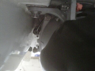

I placed the cord gripper on the inside of the ski in front of the bulk head. This is how I done mine and have seen most done as well. This way you just reach inside and tighten it up. You might get lucky if you had a box end gear wrench that would fit it. Other wise hate to say it but ,you may have to pull your pump to get it tightend with a regular wrench.
