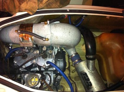

yeah ill take some pictures, its good definately boosts the power, it's fairly heavy, some guys complain about it breaking the L bracket that comes with it after a few seasons of use. it is recommended to run a girdled head with it because of the weight but i ran mine all last year without one and no problems. I have an ADA head on order tho.

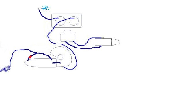

This is how i run mine, the red thing is the Flow control valve. I wouldnt recommend running a single cooling line to the coffman pipe. And if you are running salt water i would suggest a hose hook up
