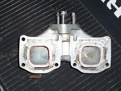

Can this pipe be put on a 701 motor? If not im guessing that the 701 will have to use the factory pipe. This is going on a 91 square nose. thanks
lay a 701 gasket over it, drop some bolts thru to line up the holes, mark it with a sharpy and grind away.
you basically grind away where I marked in red, to match the gasket.
its easy.
