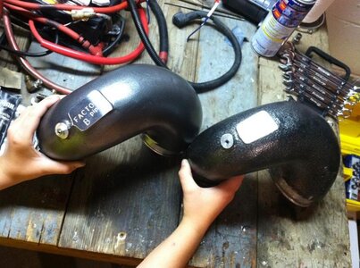

On a seperate note. I recently ordered a new Factory B-pipe for my Superjet and was comparing it to an older Factory B-pipe from my 1996 Blaster. I have two new sets of gaskets that I got from Factory. The new head pipe seems to fit the gasket very well. The older pipe seems to have a much smaller opening. Is this normal and should I entertain porting the old pipe to match the new gasket?
