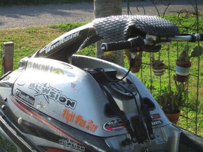

Just got all my goodies in from Blowsion along with a new glue on pad cover. my oem one was still wet from last summer. thinking of drilling some ½” or ¾” holes in the plastic to help it dry out so it doesn't un-glue in the future. Think that’s a good idea?

OR ... tear off the wet foam and throw in trash, and glue new foam on your pad. and then install your new cover... I seriously doubt you will be able to dry that foam out

that looks good . I have never tried turf over a stock pad. which is why I recommended adding underpad. I always make a new fiberglass chinpad, and turf that.
The stock plastic is pretty tough to turf, but it will stick if you let it dry & paint it again with cement multiple times...And lots of heat for those curves and bends.
I managed. And I can't turf for beans!
