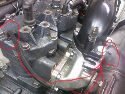

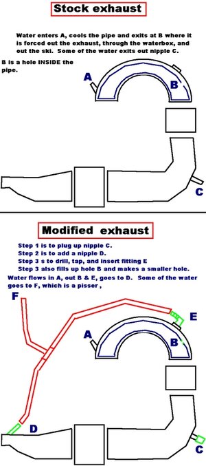

No block off the 1/8 line coming out of the head. The 1/4 line coming out of the head pipe is the pisser line. The 3/8 line that comes out of the head connects to the other 3/8 fitting on the head pipe.

i take it back, i went to braize it on last night and melted the brass fitting twice, so ill have to get it tig welded. yep the stinger is stainless. I got a Brass nipple from homedepot and cut some of the threads off so it wouldent be so long
