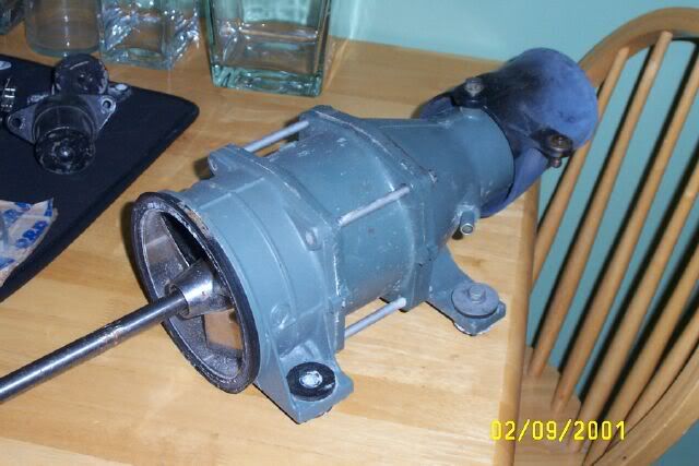

I found a pic of a stock fx-1 pump
So is the black part just in front of the impeller the seal you were talking about? Does the pump need to come apart to seal it up? Are there areas inside the pump itself that can (and do) create cavitation?
Where are the wear ring, stator and reduction nozzle in the picture?
Looking from left to right, they are in that order. The section that surrounds the impeller is the wear ring. The part that is stationary, but contains the bearing assembly for the impeller to rotate is the stator, and the part that reduces the pump flow and supports the stearing nozzle is the reduction nozzle.
