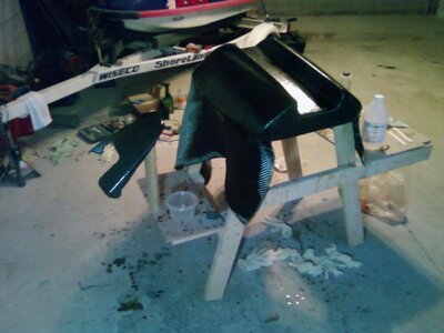

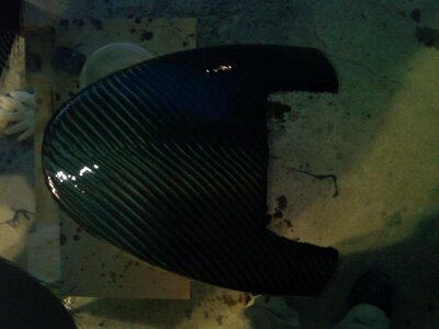

i had to do 2 pieces on my hood. 1 on the front flat portion and one over the whole top. the key is to put the seams in places that blend well.
the only concern i have is the cost of the carbon that you will use on your 550, is it worth it for the look. i used 2 yards to do my hood at $57 dollars a yard. (i could have almost bought a new hood for what i spent in supplies and sandpaper and tools) you would probably want to use 4 yards. not to mention the resin and time. it took me 2 weeks to get it done sanded smooth cleared twice and buffed. its a lot of work and not recommended if you have never done such a project. making the contours is not easy and you only get one chance to do it right once it is down if you try to move it around to much it will disturb the weave.

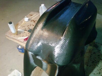

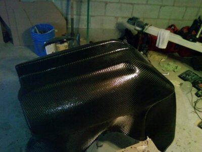

all at once. you wont be able to match it cuz the edges fray. its very easy to disturb the weave also. if you lived closer i would help you. it takes a lot of resin money patience and time. i cannot express that enough. think very hard about doing this project. here are more pics during my process.

did you paint over yours when your done? from the pics it looks like you sanded through parts but it might jsut be glare.
no paint here, just epoxi topcoat. the last 2 pics in the link show the bottom before (under) the final, viewable layer of carbon. i reinforced the runners and other parts of the bottom with different pieces of carbon and filled with epoxi filler to smoth out the edges of the pieces. this is what looks like i sanded trough the carbon.
