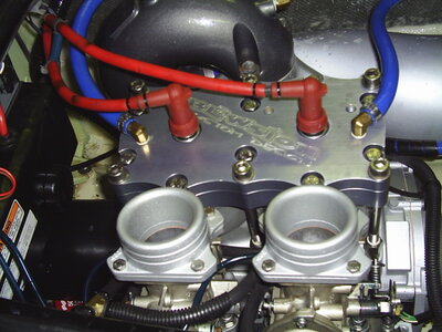

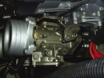

Who can I contact to help me with my carbs for the following setup:
Engine:
700cc 760cc bore
Boyesen Reeds
Factory Bpipe
Blowsion Head 195 compression
Lightened flywheel stock
Stock cdi
Cylinder Freestyle Porting
Stock Crank
Dual 48mm mkuni carbs with riva flame arrestor and riva manifold...anything else needed to please help me?
Thank You for your time!
Exile.

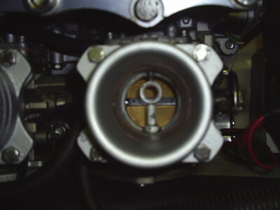

It says on the carbs mkuni,but on my invoice it says dual 48s with no manufacturer? I was under the impression mkuni only went up2 36....
So in short its dual hsr48 mkuni,what should I start of with the lowend screw and then topend screw...? I just want to do it correct and not blow an motor or damage it in any way.....
