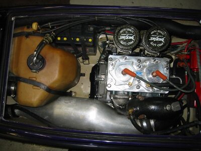

hey guys, I am under the impression that most flush kits attach from the stock exhaust. i have a B pipe and im wondering where i could install a flush kit.. would that unused brass nipple on the head be a good place? any suggestions?
Get the blowsion backflush kit which fits into your water bypass outlet on the outside of your ski and BACKFLUSHES your ski which is better than a regular flush(anything in there goes out the way it came in ).
It hooks up to a hose and plugs into the outlet and no extra fitting or clamp to worry about inside your engine compartment.
You flush with the hood closed to so you won't piss off your neighbors .
Comes in single or 3 for dual cooling works great I have one and love it .It has a little valve on it to turn the water on and off too .BRILLIANT .:arms: :arms: :Banane01: :Banane01: :Banane01: :cheer: :cheer: :cheer: :cheer:
