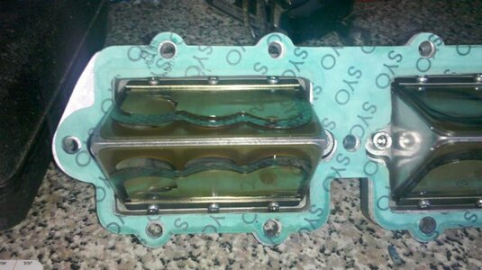

Eaxhaust coming out of one carb after getting water out of hydrolocked motor. Carbs were not right before this but reeds were fine when istalled two days ago for maiden voyage.
yes it can happen,but ive had really bad experiences with those boyeseen 3 stage reeds with as little as 3 rides,I never swamped the motor,and they still were gapped out just like your bottom set in this pic,no cracks.the last 2 stages wear out REALLY quick
