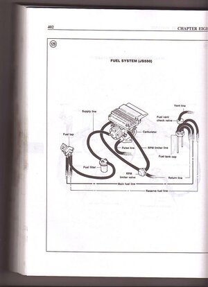

try spark plug grounding out method but also it takes them alittle long to get going once all the gas drains out from the fuel lines. a primer kit REALLY helps. what I do is get a cheap syphon kit and pull the fuel through the fuel lines and attach it to the carb. It gets it 90 percent of the way there. make sure that the fuel lines are hooked up right too! once this is all verified place your hand over the carburetor with the F/A taken off and crank it over until you visibly see fuel coming out of the carb on the inside.
it has spark when grounded on the motor. I didn’t even think maybe the previous owner messed up the fuel lines... I think I’m going to order a rebuild kit for the carb off amazon and double check all the lines are correct and try it again. Thanks guys!
