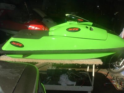

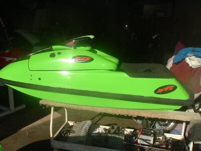

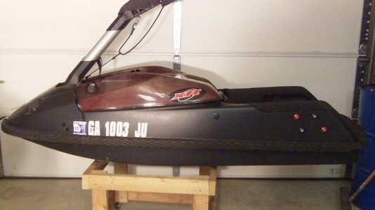

this is the XTF i bought in jan 2009 from norcal ex. it was basically new with a few months on it.
it was the sickest thing out at the time and i just had to have it.
dasa 5mm lamey power valve stroker,85mm bore, 850 it was called.
blew it up last season, when the POS hot rods rod snapped in half, cut the motor in half.
replaced it with the -5 superfreak badass, but now its time to get it back together.
i traded it off for that rickter i'm selling, but bought it back a few days later.

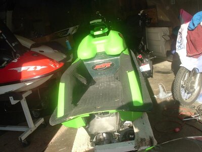

it was complete, minus the motor and electronics, but the kid i traded with, tore it pretty much apart, so here we go.

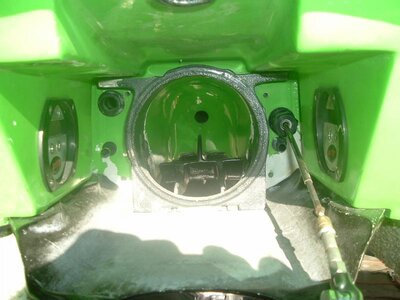

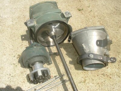

the motor and pump are set back 2" with alternate engine mount inserts and a special XFT 2" thick pump shoe.
alternate holes mount the pump 2" back, so this thing looked pretty crazy in 2008 with the pump hanging out the back.
with everything moved back, it makes flipping much easier. oh, and the hull is a -3 slant cut on the back.
with everything moved back, it rides very nose up until you plain out, so the short pole is a must or it would be in your grill, trying to get on it.
