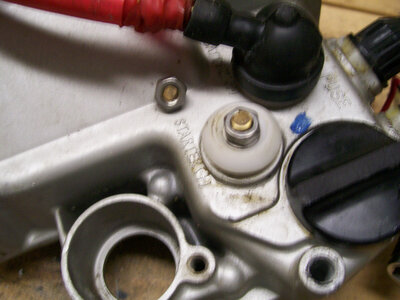

I would just add a washer and bolt the cable down. Might want to use some loctite.
What's the worse that can happen ?
It won't work and you will have to buy a new one ?
You can buy the solenoid post(bolt) from hot products.
You can also use 1 off any 650sx, 750sx, or sxi they are all the same
