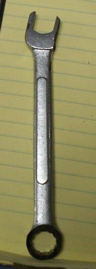

I don't know what size bolts you have in there but I have 13mm bolts in my Riva manifold. I took the boxed end side of a 13mm wrench and took the grinder to it, made it really thin. Fits in there and works perfect.

It's a 13mm just like yours. How thin did you have to make it?

I didn't have to make the boxed end side much thinner, but it fits in there fine, as long as my Riva manifold is almost the same as yours. Sorry the pics are bad but you get the idea. Be sure to grind the side that will go over the head of the bolt first.
