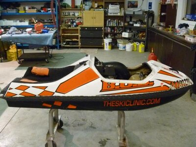

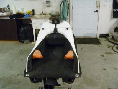

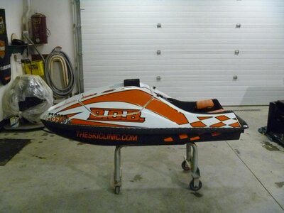

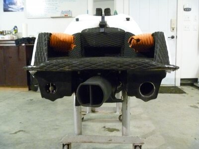

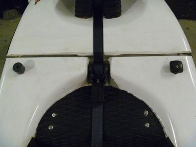

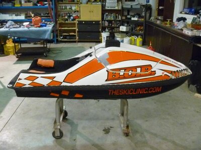

Just though Id show you some pics of my new build, its almost done, needs a pole and bracket and a few finishing touches.
The tape on the graphics is there to hold it as it re-glues and I need to re-turf the foot hold as you can see.
Specs: BOB Gen 1 #32 Lengthened Intake Cavity.
Yamaha 760 with Pro-Tec Pipe
Pro-Tec Exhaust Manifold
K&N Air cleaners
Ocean Pro Steering Nozzle
Most likely an aftermarket pole, probably x-metal
Maybe new graphics.
Possibly trim soon, just want to ride it,
Pro-Tec Lengthened Intake Grate
Aftermarket Impeller, not sure what pitch it doesn't say.....
Im sure I am forgetting lots of things, still some to do, hope you like it
Looking to be the youngest to FW Flip this beast
Build it all myself :)

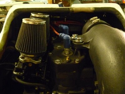

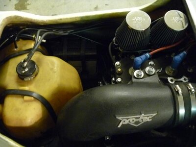

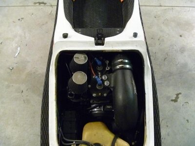

Thanks guys, Yeah I might need a pole eh? HahahahYeah it went to gether so easily, The Ebox went in so easily, but tyen my pipe chamber would fit, so I had to make a bracket to set the ebox to the left do it wouldhit the pipe I can get a pict if you want sure
Looking good Owen you are going too like it. can you post pic off the ebox mount ???
Hey man sorry I posted my last one with my phone at school
Lots of spelling mistakes.
Ok I cant really get a pic for you, you wouldn't see the mount
Heres what happened.
My ebox went in perfect but then my pipe hit it and would not go on the manifold.
So I bolted the left mount (when looking in the ebox) reversed and took two pieces of metal that I had laying around and mounted them to the ebox and mounted the ebox in. Understand? Haha might be hard to though
Sounds like just the way i did it

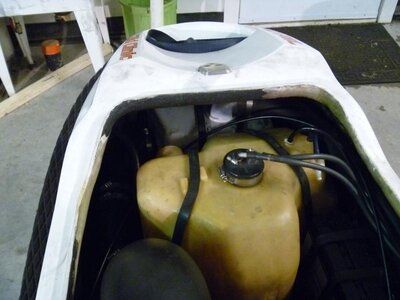

Just an update, cleaned entire hull, routed all the correct lines and made them neat,
pealed numbers off and looks great just a pole and pole bracket and its ready to ride!
