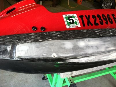

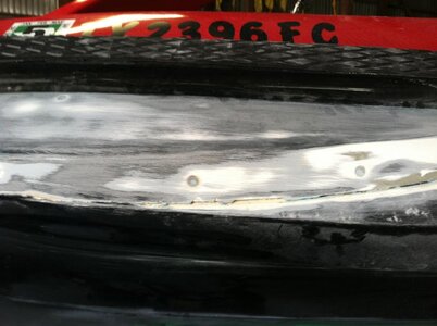

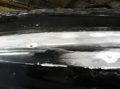

Here are some pics. You can see that one screw backed completely out. Most of the separation occurred on the bottom. I have already sanded/chipped away some glass and filler.

My destroyers use bolts that go thru the hull with stainless nut/washer/flaged asseblies that glue to the inside of hull so i think your idea will help, they definatly wont be loosing up and backing out on you.

im not sure why your part is coming off but I wonder if that screw actually went into the hull? did you cut off the excess? did it get too hot and melt the resin in the hull thus making it not really screwed in? I like to mix thickened epoxy with cabosil instead of 5200. this way when it squeezes out you can use it to bond and fair the edges. then put the glass over it and epoxy that on the edge.
bigger longer screw, cut slowly to not heat screw up to much and cover with glass? for the edge mix some epoxy and cabosil after sanding all the 5200 away and then glass over. that would be what I would do. hopefully that helps.
