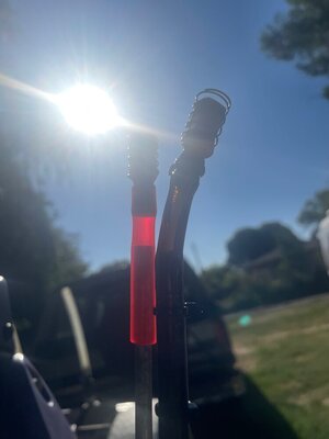

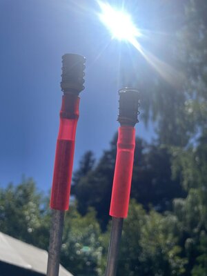

Don't look significantly cleaner in the second photo, but they are, and the check ball which was stuck in the primary fuel pick up freely moves.
The aluminum pickup tubes had white corrosion on them. I brass wire wheeled them and ordered some 316 stainless 1/4" straight tube.

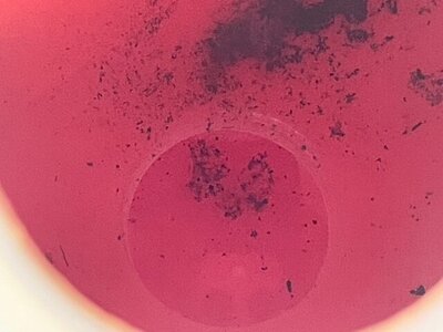

Tank photo before cleaning:
