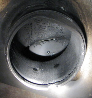

I bought a Jetcraft Turbomuff off a Kawi 750 to try out, so tonight pulled my box to see how it's going to fit, and noticed my waterbox wasn't rattling anymore.
Looks like one of the baffle tubes is wedged under the inlet SIDEWAYS.
That has got to hurt my power. Looks like I'll be putting the Turbomuff in before I ride again.
