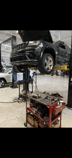

Later I verify the crank in fact won’t turn with a breaker bar so pull all the spark plugs and inspect all the pistons and Cylinders and find no damage. Next I inspect the timing chain with a camera and find its intact and not locking the crank.... now I’am like wtf?
So I come up with a bright idea, drain the engine oil into a clean container and inspect the lower end that way... we’ll it’s full of metal, brass.... so my thought now is it spun a bearing.. its AWD so pan removal is a little difficult... Well low and behold it seized all the main bearings... see how hot the main caps got ?
Thinking further it looks like it had some prior wear and metal debri was partially plugging the oil pump pick up screen and it just coincidentally failed while I was driving it..
