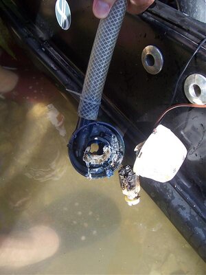

noticed smoke, and a burning smell coming out of my boat while getting a tow yesterday ( ran out of fuel, reserve didnt work, sperate issue)
so I remove the hood, and see smoke POURING out of the engine compartment, so of course, I roll the boat over and sink it.
this is whats left of one of my bilge pumps, I can barely see a zip tie hung in it, I assume it locked the rotor from spinning, and ive got a 10 amp fues, since smaller ones kept burning up, so I guess I had a 10 amp fire for 45 mionutes while being towed.
this smelled TERRIBLE.

I was just wondering yesterday how bilges handle small debri like that LOL, question wondered, question answered LOL. Good thing I shop vac my skis out after wrenching and after every ride LOL. I bet my shop vac is loaded w/ wire ends, zip ties and 10mm nut and washers LOL.

Kind of makes you glad you ran out of gas. A burned up pump is better than a big KABOOM!
It may sound silly to say about a bildge pump, but glad your ok. I worry about wires going bad in my old ski with all those gas fumes.

Thats what you get when you have tainted bilge water:crazy: That sucks man, I would have thought that a 10 amp would be the best choice. Thats what I run for my 2 pumps. My guess would be that the overheated motor was hot enough to melt but still drew less than 10 amps. Thats just freaky. I thought the bilge pumps were supposed to be overload protected and spark proof? I would send that picture to Attwood customer service and maybe get some freebies out of them. Yeah right..

I had the same thing happen before I knew better than to run a fuse.
On the bilge pump packages think I remember it saying they only draw like 2.5 amps each.

I should send them the pics, im sure they will say it was my crappy wiring and oversized fuse to blame though.

are you saying you DONT use a fuse now?
