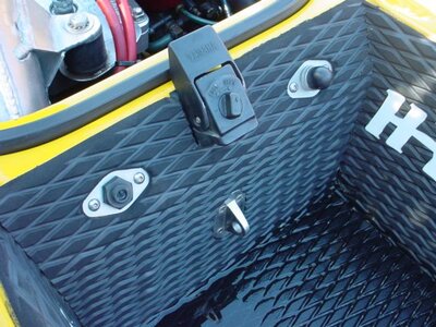

Yep, I quite like it on the dash, I just thought I would try something a little different. Here's the result...
