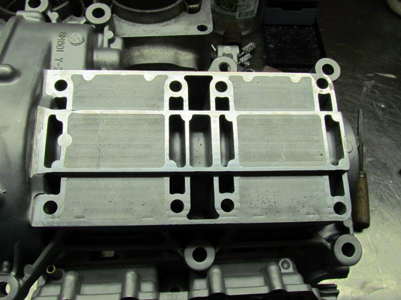

I use heat resistant epoxy and mix it up with aluminium powder you need to let it cure 24 hr on room temp and then postcure it 15 hours @ 150 dg F after the postcure the resin is stable to 300 dg F with normall epoxy the resin will become soft @ higher case temperature.
