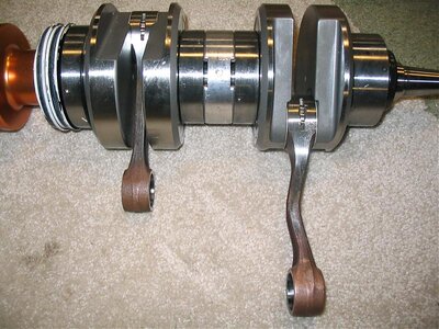

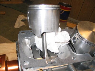

Bent stroker rod

eel no cracks. I say that cause LPW ask me to double check. I used a magnified glass, and found a surface hairline inwhich a couple strokes of a file confirmed. Thanks for looking so close and scaring me into another sleepless night!
When a rod gets to look like that and the big and little ends are still visually in alignment means that the piston was the only thing stopping the rods desire to look like a banana. :Banane01: Personally, I would not run that piston in an engine that I put a lot of time and coin into, even though it seems fine.
