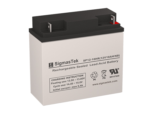

I know a few years back a lot of guys were running these batteries in their skis , so I was looking at some links in my BAMAFREERIDE database and saw these were on sale cheap
they measure 7.13 length by 6.59 height by 3 inches width. basically a similar foot print as a Ytx20-lbs , they are 18ah batteries CCA is not rated but I know they are used in standby generators for cranking.
I have a jump box and this is the battery they use inside of it.
They are on sale for $23.28 plus shipping to get one here is like $41.69 , these are made by Sigmas tek .
They also have a 22AH battery for $38.00 with the same footprint.
I am buying a couple just to have around for working on sales skis this Winter.
Also at Amazon for even cheaper.

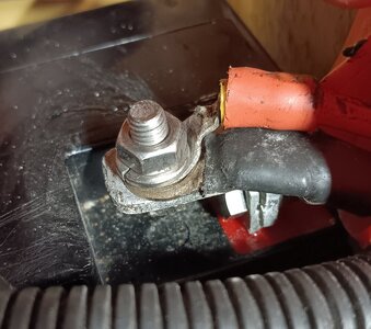

I run those batteries in my jetski's and my street bike (Suzuki bandit 1200). I maintain them during off season and I get many years out of them. For the jet ski's I create an angle adapter out of angled aluminum. I tap threads for the upward facing bolt so all I have to do is tighten the nut to install the cable.

Good Idea to make Cable installation and removal easy.
But why am I seeing a Red Cable and a Black Cable both attached to the same Post? o_O

It's the positive terminal. The lower cable is red but you are seeing the black sheathing at the terminal. The upper cable goes to my bilge pump.
