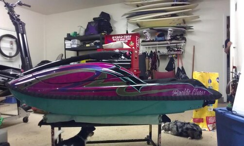

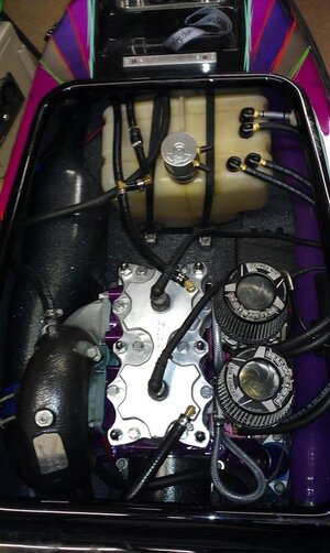

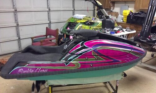

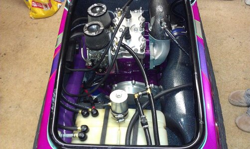

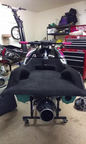

Well wanted to put up a build thread for the Backie 'Chick' This ski was primarily built for my girlfriend who is very petite but with also knowing that I would be riding it as well(hence a front foot hold). Not a crazy powertrain because as for right now its set up for my girlfriend but should still be a very snappy and fun ski to ride. Ski sounds like a raped ape and Water tests will be done this week but as far as the build is concerned its finished: Motor is a 701 61X motor, dual taper bored 44 mil carbs, lightened flywheel, limited b pipe, solas pump section, 550 gas tank, msd cdi, front foot hold, x scream mid length pole. Hull is a backie chan fiberglass hull with custom paint by trendsetterz. Ski is very light and I will be weighing it soon rtr as well. Was very pleased with how it turned out and the fit and finish of the ski was just to my standards and expectations for an A/M hull. Will update more when I get to it but here you go as far as pics:
