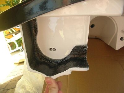

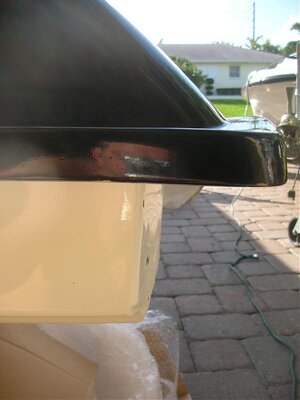

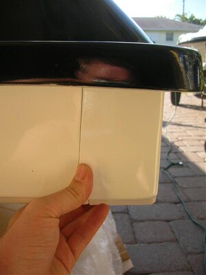

We have a new hull from TKo that is 3 inches shorter that has hull extensions that can be install if you didn't like the way it handles. The hull extensions allows you to have options. I'll have more information on these hulls soon.

that is a really good idea...you should make it so the extensions are removable easily so you could stick em on for surfriding and take them off when you want to hit the lake...mabye glass in some inserts so you can just take some screws out or something
W
wydopen
Guest
fwiw, thats exactly how the TKO's are set up. get to the beach, screw your extensions on.. get to the lake, take 'em off.. :biggthumpup:
