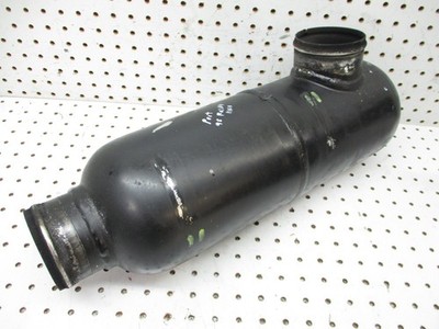

Does anyone make a water box with 3 in and out?

One more thing and forgive me if I am wrong here but I am working from memory but I believe the Rad dudes boxes were just 701-760 waterboxes with bigger inlets and exits tig welded in , most of the Yamaha sitdowns except for the Blaster, VXR , Wavejammer and the Waverunner lll had the nicely made round aluminum waterboxes.
If I remember right they were doing this because Waveraider boxes were getting hard to find and at the time the demand was really high , now , not so much.
