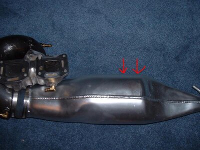

I have a Limited chamber and need a mod chamber but they're hard to come by and i'm on a tight budget, could i shorten the limited chamber or is that gheddo?

yes, you can shorten it. thats what factory pipe did on the early mod chambers. not ghetto unless you weld like helen keller.

I think that you take 1.5 inches out of the big end of the chamber right before it narrows down to the outlet. I did mine several years ago, just get someone who is good at welding aluminum and you should be fine.
