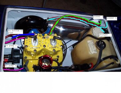

I can explain it but if you've never installed one before, you probably won't be able to visualize it. So here is a crude picture... Hope it helps. This is setup with 2 cooling lines coming from the pump and both of those lines connecting to the exhaust manifold.

Lol yes this is true...but if one gets clogged that means one is running fully dry...and that leads to kabooooom. That being said I still run parallel cooling as you explained...
