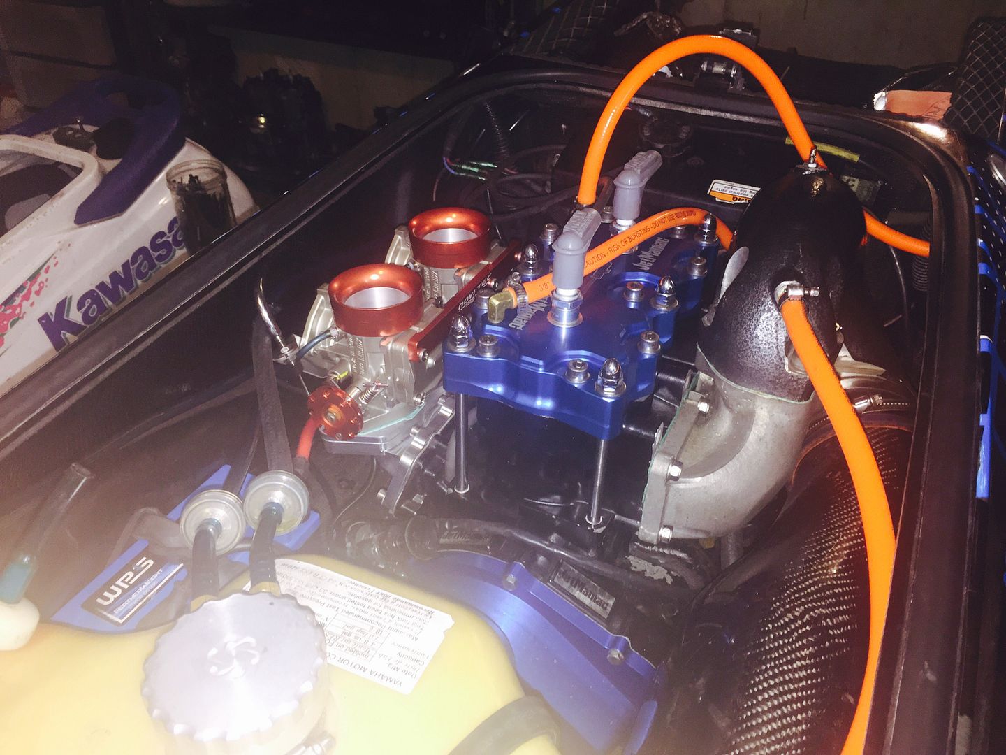

mine would not fit OEM carb air boxes.... mostly because between the boyeson (sp) intake manifold and the Thrust carb adapters I am running (also running FS 49mm carbs) they set up too tall and hit the hood seal lip.
I cut up an OEM single carb box, then used plastic weld to fabricate a mold. A friend did me a favor and had two poured for me. They are the same overall height however, the backside is angled down to clear the hood seal.
They are hard to see from this angle, but you'll get the idea.
