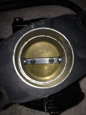

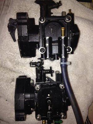

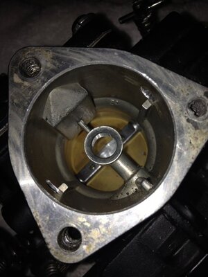

Received these carbs need help identifying them. 34's or 38's?
Mains 135
Pilots 70
95gram springs
1 carb has a 1.5 needle and seat the other has 2.5 are these supposed to be the same?

I may be wrong but the 34 probably denotes the size of the venturi. Since there is the step up inside the carb bottom is 38 and ventury is 34. Just a guess though
