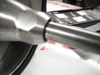

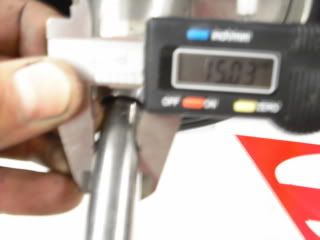

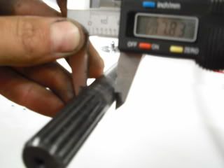

Are the SJ pumps supposed to have tapered pump shafts? At the splines it measures 17.7mm and it tapers down to 15mm. It also looks to have been shortened and welded. The shaft seems straight though. I just have a feeling that ive got the wrong shaft in this ski.

Has to be tapered... The splines are bigger than the majority of the driveshaft. I never actually measured it but even the 750 driveshafts are tapered but the SJ shafts are more obvious if I remember correctly.

Ok good to know but all this came about because i was trying to make up the gap between the prop and shaft that you can see in my pics. Any one know what im missing there? I tryed to use a mag light head but it didnt help because of the shafts taper. If it slips over the shaft by the time it gets to the prop it has the same gap.
