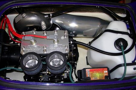

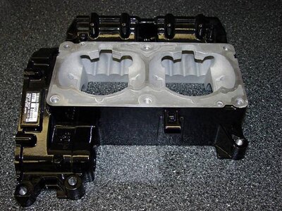

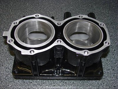

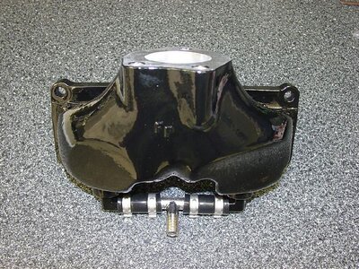

I used powder coatings on all of the engines external surfaces. The powder coating was sprayed on with an electrostatic gun and baked at three hundred fifty degrees Fahrenheit for ten minutes. This epoxy coating is very durable and scratch resistant. The only draw back is that, if you ever have to install cylinder sleeves, you will have to acid dip the cylinder and have it recoated after the sleeves are installed. After the parts were baked in the oven, I checked all the surfaces with a straight edge and they were fine. I used ceramic chrome coating on the B-Pipe chamber and the black epoxy powder coating on the exhaust manifold. The coatings have held up for almost a year now in salt water use every weekend.
