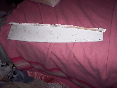

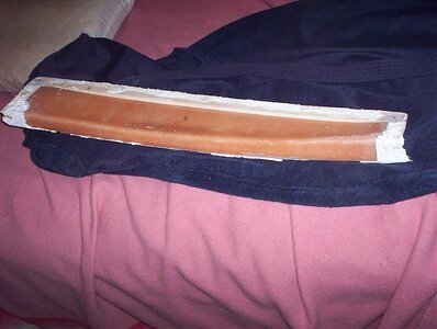

I have some RnD race sponsons that work fairly good, make it about an inch wider in front. $25 plus ship.

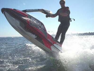

Side note, CPR runs these the polycarbonate on his freestyle ski and swears by them, said he had to round the edge a little because they got a little too aggresive in the turns.

No problem, just trying to get rid of stuff collecting dust. One thing I did notice, my ski was a race ski when I got it and did close to 60, it was extremely stable at top speed due to these sponsons, I'm just a puss and hate going over 50mph.
Yeah, I had those R&D sponsons on one of my old race boats. It helped stability at all speeds. It wouldn't do as well as Tubbie's at keeping the nose up in surf. However, I have found that tubbies chine walk pretty bad at certain speeds too and that's annoying to me.
