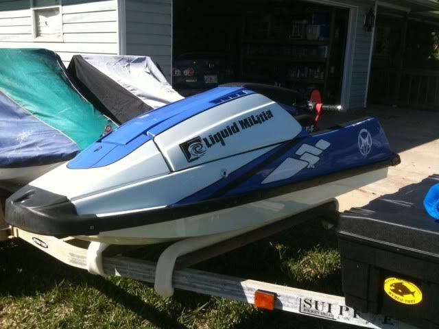

well the day has finally come, I was able to talk the wife into letting me do it, and a few months to find one with a title, but I got me a 91 RNSJ! And it was from the original owner too! Its used to be a race ski, but for me its going to be a surf/flatwater toy for me. All I need to do now is put a new bilge pump, and I have a rule 550gph ready to go, and this next winter, I will have to put in some new turf and footwells in and I will be a happy boy!
760cc big bore-Stainless B Body pipe-aluminum waterbox and handlepole-MSD ignigtion-14/19 scat-trac impellar and new housing-twin 38mm carbs and high compression head-pro-tec ride plate and intake grate

and now I blacked it out

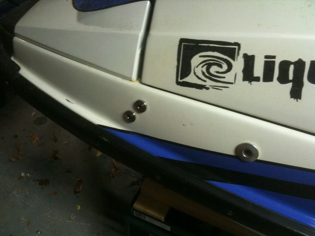

Also getting ready for the surf I made my own limiting rope, and hood staps. I got the straps some strapworks.com, cut them and made a hole in it, and used the bolts in the dash for everything, and I got two SS black clips and rope for a tow rope velcroed on.....

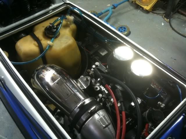

I replaced the primer and fuel lines, and re routed them, is it ok for the fuel lines to sit on the exhaust tube?

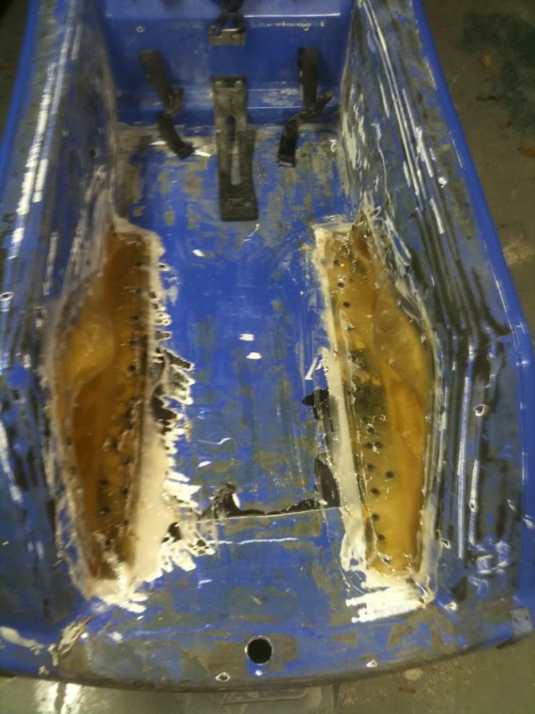

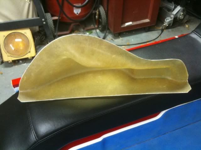

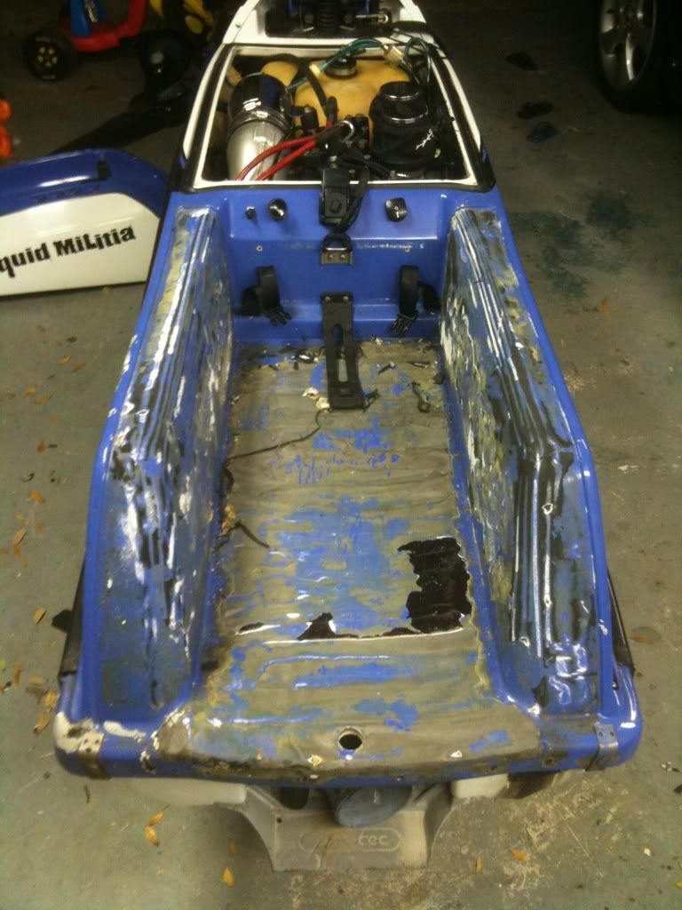

well I am finally getting started with the foot holds. I removed my turf today so now its time to get ready to cut!
Also, would it be beneficial to put some small drains in the tray to drain any water that might ever get in there?

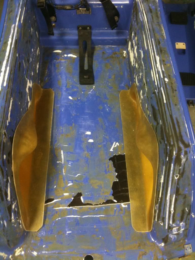

Here are the holds in there holes, now I just need to get them in! I am very suprised to find I had very dry foam, and a wire wheel works wonders on removing the stuff

well today went well, Speleopower came over and helped me out getting the holds in. they fit ok, and the rivets didnt work out to well, so in the middle of our mix we had to switch to screws to pull it in, but overall I am happy. Now I need to get them sanded down and ready to foam and put some more glass down.

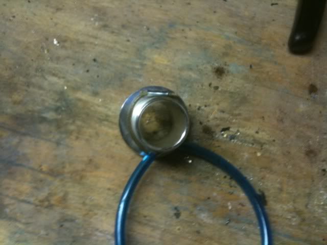

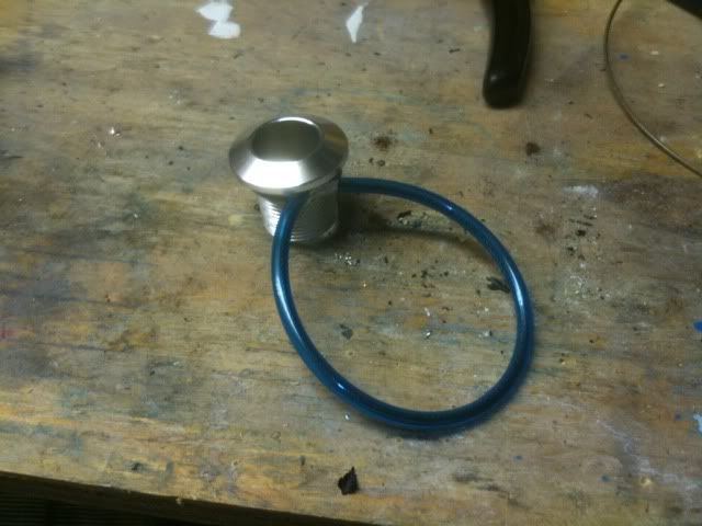

I also got my new SS pissers in, and ran them up to the nose. The previous owner had it all the way back in the tray where you couldnt see it, and most of the time was under the water, now I plugged up the hole with a aluminum plate 5200 on the inside, and epoxy on the outside.
