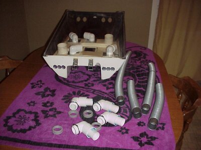

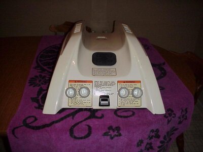

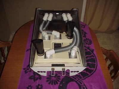

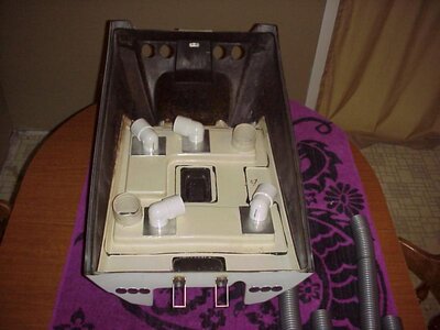

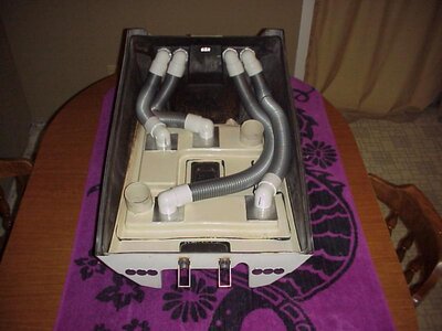

thought i'd throw in up my hood mod. from about 4 years back i had done to my 91SN. pretty simple, drilled 4 holes in the liner and routed it out the back. the parts came from HD. the aluminum plates/hoses were glued with 5200. i used clear duct tape to cover the vents on top. stock weighted 18 lbs, modded weights 21 lbs. worked pretty good
