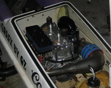

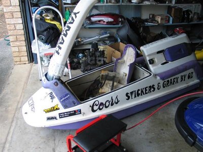

Well i am putting a new pole on my new superjet so i wasnt sure what to do with the old one
I guess its going to go on this thing now
Will be looking for a spare 650 kawasaki pump now
Will run my spare race engine in it with 44,s and some pipe i just not sure what one yet

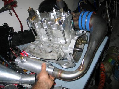

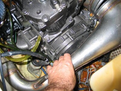

Hey Guess what other pipe fits in the fx1
an old school 750 pjs mod pipe
Lucky i didnt sell the inline scilencer
Wow who cares about the weight of a water box im taking it out
Damn and i just sold my last b-pipe exhaust manifold as well

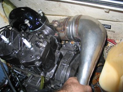

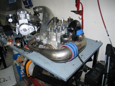

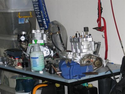

Well here is the pjs pipe mounted on an engine
well actually its the engine i will put in the fx1
its my spare race engine with v-force reeds
extensive case porting as per that other thread
cylinder porting etc
and maybe 48novis
I want to make sure its got some go in it
No need for slow boats

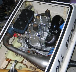

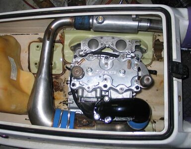

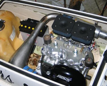

Ok well here it is in the hull
I wonder if the price of 750 mod pipes just jumped a little like 650sx intake grates

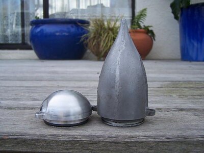

I would be happy with the std pump cone as i will more than likely go for a r&d pump cone anyway
i might take you up on the beer if/when i come to aussie next :cheer:.
ill email you tommorw with some pics and a price on shipping . ill make sure its alot cheaper than when i sent you the msd total loss .
i can make you a pump cone to any specs you like to save you money if you wont . ill mahine it up at work so it wont cost me a cent if i can find some alli laying round . here is a pic off one i made for my x2
